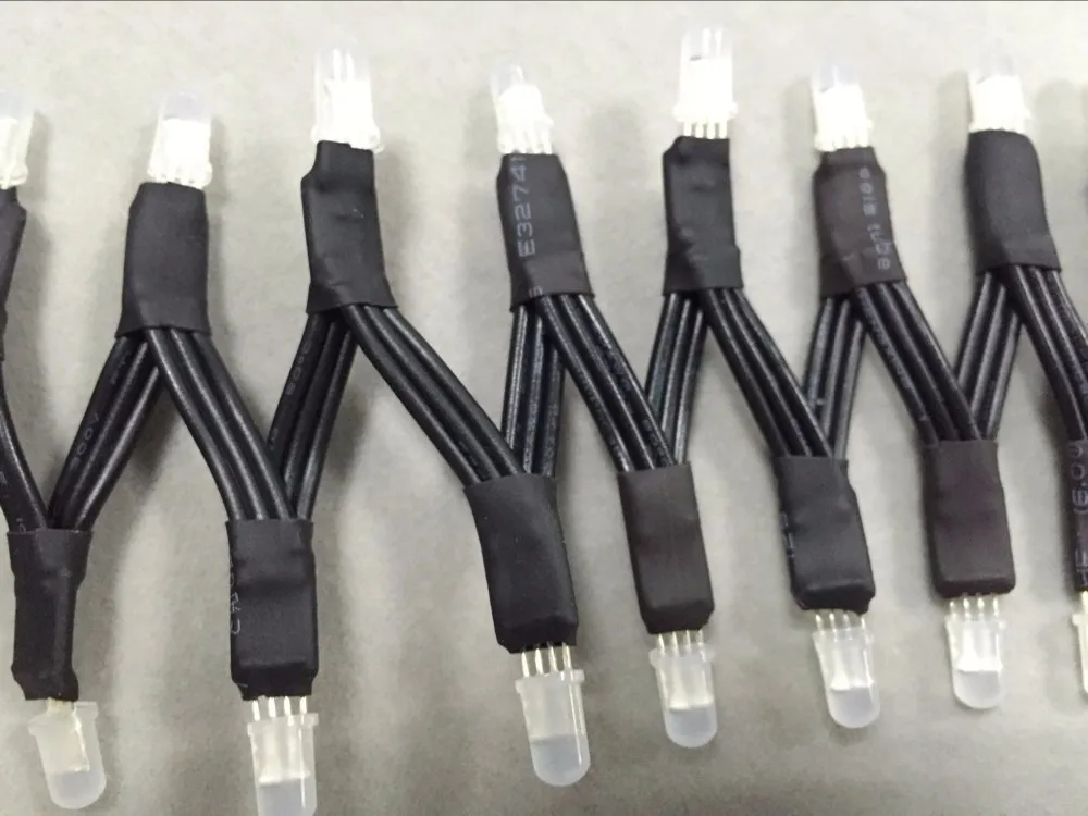

So Ray sells these as well:
I'm going to get a couple of samples from him, and I'm curious what the boards have on them in these examples.  Perhaps they are just a couple of resistors mounted.
Either way, this is a step towards your idea of a socket.  It would be wonderful to have something as mundane as the current mini-light sockets... and if a pixel burns out, just replace it.  You might even be able to waterproof the connector.

I've seen those as well.  Not really what I'm looking for, and doesn't look even remotely water-resistant.  And in that configuration (pointing opposite direction), I can't really think of an application I would use them for.
I'll be curious to see what others come up with, but based on what I was wanting to use them form--at the end, I really couldn't justify using these over just using a normal strip.  Especially given the amount of time that it would take to get a bunch of these into any working model.
