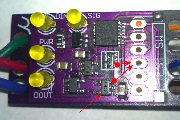

twooly,  I took a look at your video.  The DOUT led should not be on like that during the start-up.  There are a couple of possibilities for the issue,  Based on your picture of the front side of the board,  Can you take a closer look or a more detailed image of the mosfet driver?
The driver (red arrow in photo below) should have an identifying marking of "GZHU"  I don't see that mark in your photo.  It could just be the lighting, or it's possible I could have inserted the wrong chip in that slot during the build.    But one which is causing the DOUT LED to come on - which is what I looked at to make sure these were working before sending out.

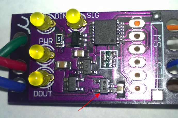

Looks like it has GZHU on it.  Sorry my pics are bad :)

corey872
The picture is fine.  It does look like the proper code.  Unfortunately, this is starting to look more like a board level issue.  The PIC seems to be working given it's flash sequence when power is applied.  But the only reason the DOUT light should be on at that point would be a high input at the mosfet driver, or if the driver itself failed and latched completely on.
About the only thing left to try would be pulling the mosfet driver input low with a jumper wire.  To do that, you would have to make contact with the input pin of the mosfet, or, one or both of the output pins of the resistor array.  (all indicated by red dots in the photo).  You would need to connect the other end of the jumper wire to ground - the easiest place would he hole #3 of the programming header (as indicated by the arrowheads)
Jumpering the input to ground, the mosfet driver input would have to be low and the driver should shut off the LED.
If you want to do that, go ahead and give it a shot to see what happens.  I will ponder a bit more through the day and see if anything else occurs to me.  At the worst, if you want to send the board back to me, I will have a look, get it in working order and send it back out.
