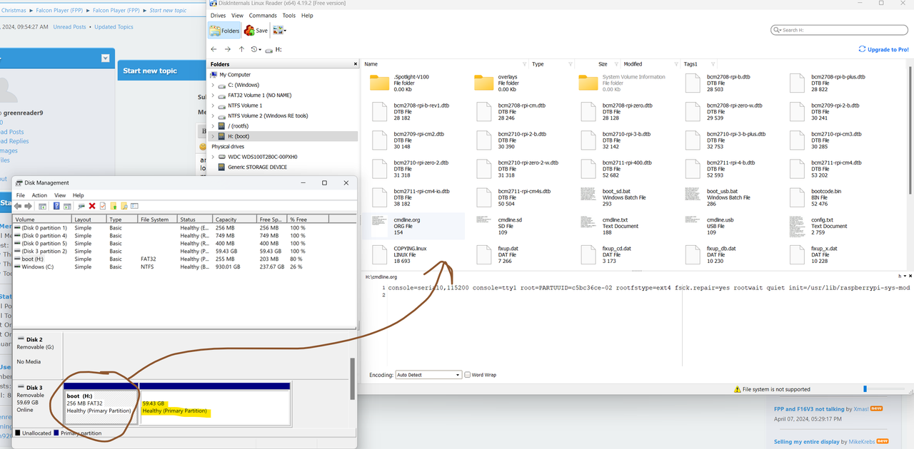

I pulled the SD card out and brought it into Windows, and opened it with DiskInternals Linux Reader. Could not find a htaccess or htpasswd file anywhere. I have a feeling that the file is in the highlighted partition, but I don't know how to get to it. I really don't want to re-install since I know I spent a few hours getting it setup in November.

The htpasswd and htaccess files are on the other, large partition.  The normal file paths for FPP are /home/fpp/media/config/.htpasswd and /home/fpp/media/config/.htaccess
I don't think that you can update those using the Linux Reader, but you should be able to see the passwords you configured during the initial setup by looking at the /home/fpp/media/settings file and then you can boot the SD card back up and login remotely.

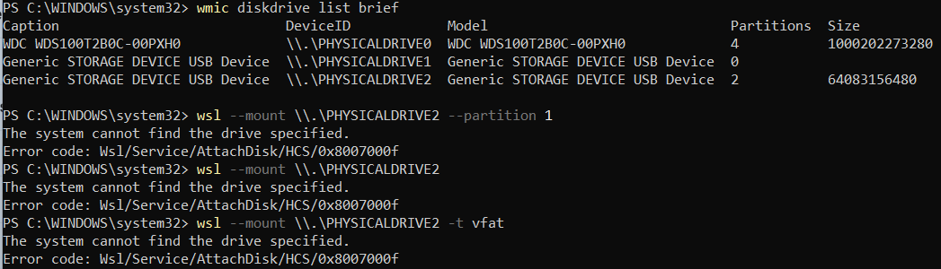

Saw something that pointed me to the WSL tool built-in to windows, so I installed that, and Ubuntu 22.04 to get WSL2 installed. Turns out that there is some long-standing issue with Raspberry Pi SD cards and that program that MS seems unwilling to fix (Link)

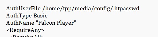

I was able to read the .htaccess file with says my username is "Falcon Player", and the config file listed the name as "primary" and the password as "raspberry", but no combination of those (Including using Title Case) worked for getting into the WebUI, FTP, or SSH.

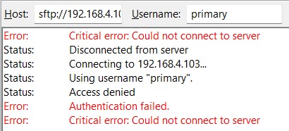

Also tried logging into FTP with username "Falcon Player" and "primary", both with password "raspberry":
If I use the FTP protocol (Port 21), I get "Could not connect to server"
Trying with SSH (Tried passwords 'raspberry', 'primary' and 'Falcon Player' for each attempt):
Is there anything I am doing wrong here, or is something just broken somewhere else?

(I am also now realizing the stupid mistake I made of thinking "AuthName" was the username and not the user prompt)
