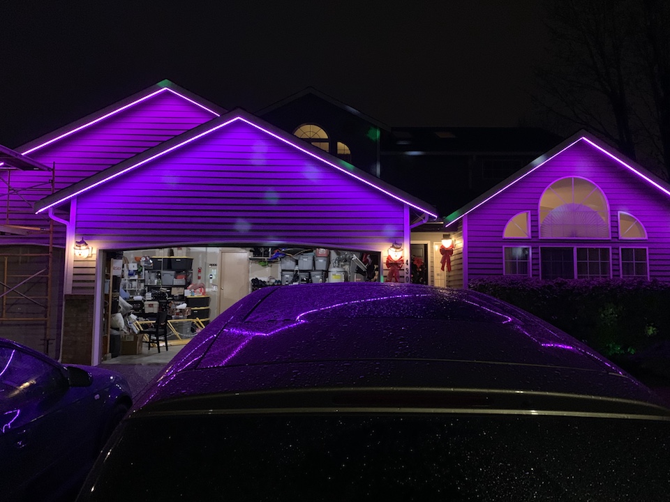

Finally, I should point out that the lower channels (strips 1-3) were operating fine as you can see in the next pic (taken back in November) so the dysfunctions appeared after the lower strips were exposed to the elements for a while. I'm coming back to fixing these for Halloween, but these have been problematic for a while (it's been dry these past few weeks, so these issues have persisted through wet/dry conditions and being unplugged for many months):
